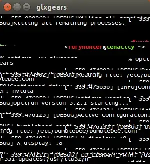

The following appears when running optirun glxgears with primus and nvidia-331-updates configured in bumblebee.conf:
primus garbage
This is on 14.04 Trusty Tahr, upgraded from 13.10. The application seems to run on the nvidia gpu, but doesn't display correctly as it did in the previous distro version. I suspect this is a bug in primus in the 14.04 repos, unless one of my packages is poorly configured.
The window does refresh and display part of the glxgears image, but only when I shrink the window, and once per frame that the window is being resized. The GL viewport is scaled incorrectly in this process as well.
Continuing some testing, the PRIMUS_UPLOAD=1 flag seems to make the window refresh properly and everything works as intended. This is not a permanent solution though.
