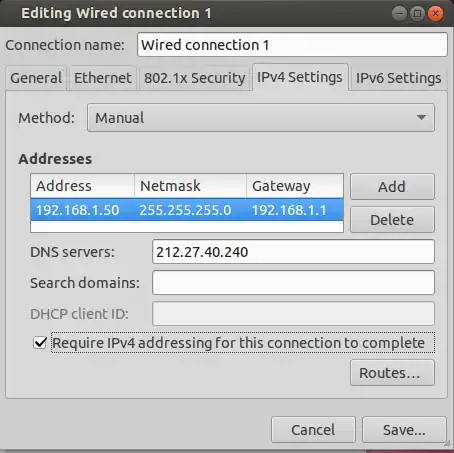

OK, the issue here is that you have set up your laptop as the gateway. Presumably, you chose the "Automatic" rather than the "Manual" approach on the guide you followed. You need to go back to network settings on the sever and set it to manual:
In the above picture, I have set the following:
  • Address: 192.168.1.50 : this is the IP address of the server. The important part is the 192.168.1, this will make sure that your server is on the same network as the rest of your local network. The last number, 50, I chose randomly, all that is needed is that it be a number beyond the range of addresses that your DHCP server allocates. This is usually your router and you should check the settings just to be sure, but 50 should be fine.
  • Netmask: 255.255.255.0 : This is to make sure that the server is on the same subnet, for more details see here.
  • Gateway: 192.168.1.1 : This is the address of your router, based on the ifconfig output you posted, this should be correct.
  • DNS: 212.27.40.240 : This is the address of the DNS server, the server you contact in order to translate numeric IPs into host names like google.com. I have chosen the OpenDNS server but you can use another, just copy the settings from your laptop's connection.
Once you have done that, just reconnect and your server should be visible at 192.168.1.50.
