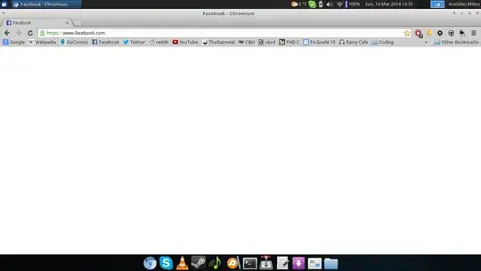

I am having issues with pages loading. Immediately after opening the browser, pages do not load. All I get is the title, with a blank page.
The request is going through; that's not the issue. I can inspect the headers, etc.
This leads me to believe it is some sort of rendering issue. After opening a couple of tabs and loading a couple of other pages, the pages start to actually display.
This happens almost every single Chromium startup. It affects the first few tabs open/pages "loaded" (usually by the 5th they render).
