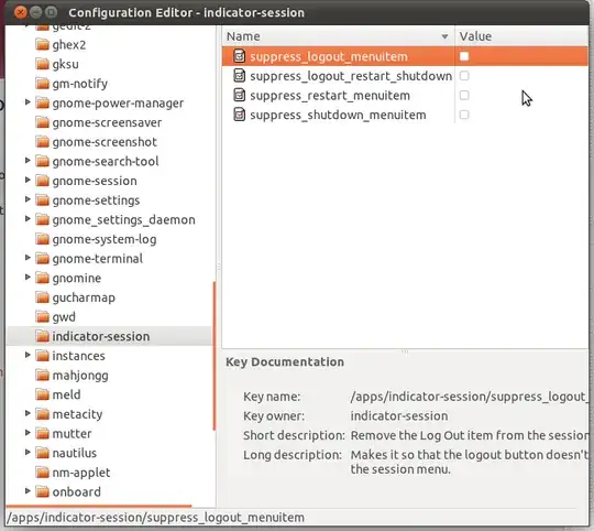

  • Open gconf-editor (press Alt + F2, type gconf-editor, press Enter)
  • Navigate to /apps/indicator-session/
  • Make sure none of the checkboxes on the right pane are ticked:
However, it would be interesting to know why that happened (maybe worth reporting a bug).
