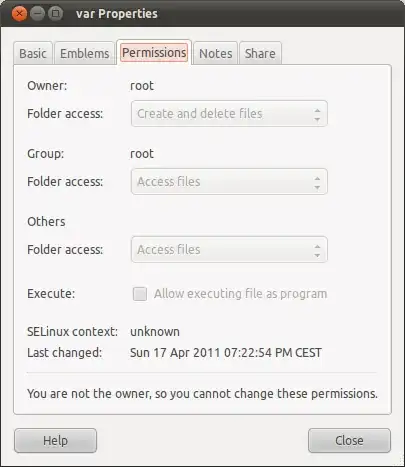

To get the permissions in the GUI you would
  1. Right-click the directory you want to know the permissions of and select Properties.
  2. Click on the Permissions tab to get this

If you are running X then right click, properties, permissions tab... otherwise try 'ls -l' in the terminal
