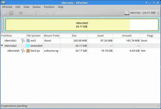

Ok, here is the problem. I have a Xubuntu in Virtual box. I have resized the machine HD and added the missing space using GParted to the patrition as seen in this picture:
After resize the new size should be 25 GB.
However when running console I only get:

So the question is - how do I safely expand my current FS to full size? I need to add those missing 6GB to my primary patrition.
