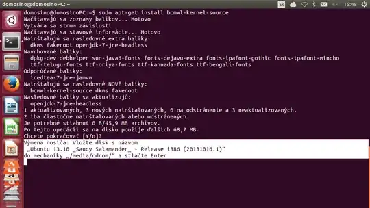

...and I connect there some print screens of PCI list, iwconfig and Installing bcmwl-kernel-source (this language is Slovakian, but it says, that you must insert install CD into media/cdrom, but I haven't got CD-ROM -_-...

I tried sudo apt-get update and Broadcom driver install in setting, but it no work :/...

Use either a wired or bluetooth tethered connection to get wifi temporarily up and running, then run:
$ sudo apt-get update
Then open 'Software and Updates' and select the proprietary Broadcom driver.
