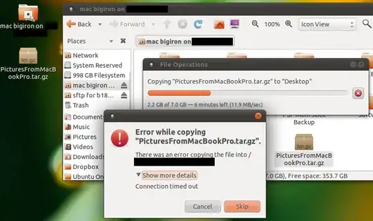

By the way, here's a screenshot of the error I get:
Screenshot of the error
