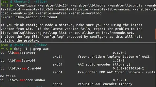

But I have this instead :
configure&make
I don't understand what I'm doing wrong here... I can't seem to use the libraries that are installed on my Ubuntu.

You need to install the VisualOn AAC encoder library (development files):
sudo apt-get install libvo-aacenc-dev
