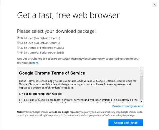

Having said that, chrome is actually an exception to the rule. When you go to its download page, you will see this message:
At the bottom is this note:
Note: Installing Google Chrome will add the Google repository so your system will automatically keep Google Chrome up to date. If you don’t want Google's repository, do “sudo touch /etc/default/google-chrome” before installing the package.
This means that the .deb package includes a script that will add Google's repository to your system (specifically, it will create a file at /etc/apt/sources.list.d/) thereby ensuring that chrome will be updated when you use apt-get.
