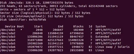

In terminal :
sudo fdisk -l
Type your password.
https://i.sstatic.net/FPRg3.png

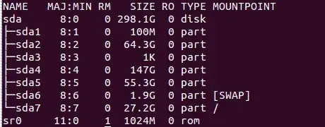

lsblk command :
https://i.sstatic.net/7egAM.png
