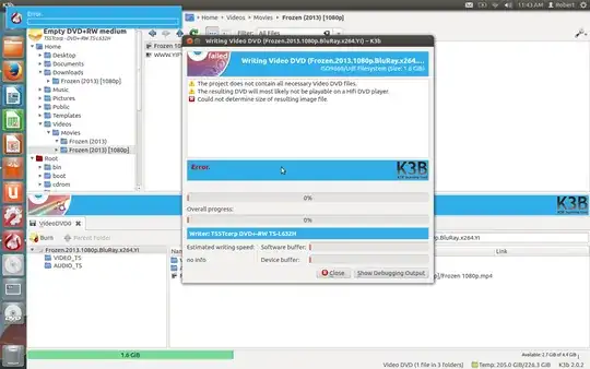

when im burning a movie i keep getting this error message
I then clicked on SHOW DEBBUGING OUTPUT and it showed this message

/usr/bin/genisoimage: No such file or directory. Failed to open VIDEO_TS.IFO
/usr/bin/genisoimage: Can't open VMG info for '/tmp/kde-robert/k3bVideoDvd0/'.
/usr/bin/genisoimage: Unable to parse DVD-Video structures.
/usr/bin/genisoimage: Could not find correct 'VIDEO_TS' directory.
Possible reasons:
  - VIDEO_TS subdirectory was not found on specified location
  - VIDEO_TS has invalid contents
mkisofs calculate size command:
/usr/bin/genisoimage -gui -graft-points -print-size -quiet -volid Frozen.2013.1080p.BluRay.x264.YI -volset  -appid K3B THE CD KREATOR (C) 1998-2010 SEBASTIAN TRUEG AND MICHAL MALEK -publisher  -preparer  -sysid LINUX -volset-size 1 -volset-seqno 1 -sort /tmp/kde-robert/k3bPR5701.tmp -no-cache-inodes -udf -iso-level 1 -path-list /tmp/kde-robert/k3bJw5701.tmp -dvd-video -f /tmp/kde-robert/k3bVideoDvd0
