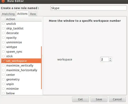

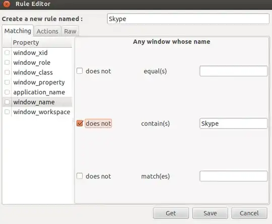

Yes , thats possible using gdevilspie ( GUI of devilspie) :
Open Terminal and type the following coommand :
sudo apt-get install gdevilspie
Now open gdevilspie with (Alt + F2, gdevilspie, Enter).
Click start daemon and automatically on login .
Example here is Skype ( you should set it to run on startup ) :
devilspie Here
Now restart daemon and try .
