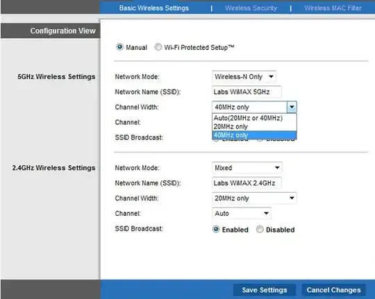

tibo
  • 131
You may find, as I did with a very similar iwlwifi device, that signal strength and stability are greatly improved if you set the router to restrict channel width to 20 MHz only and not 20/40 MHz. enter image description here
