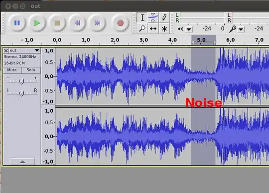

  2. Select an area containing background noise only

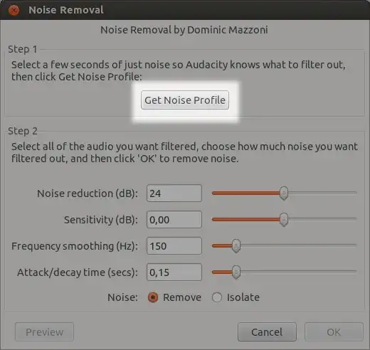

  3. Open Effect > Noise Removal...
  4. Choose Get Noise Profile to use the previous selected noisy area for filtering.

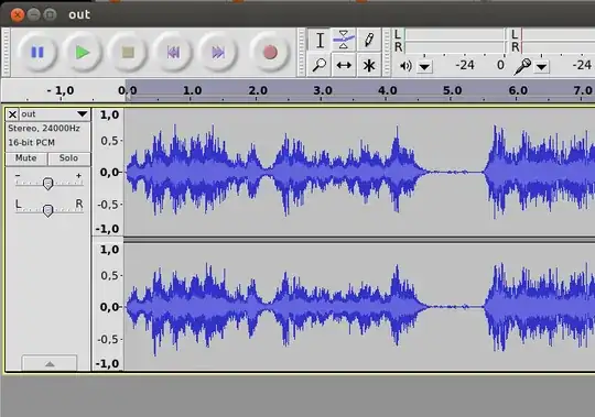

    enter image description here Background noise was now effectively removed from our sample.
  7. Listen to the sample for artifacts in case we were overdoing denoising. If so undo your work and repeat steps 2. to 6. using different settings until we are happy.
