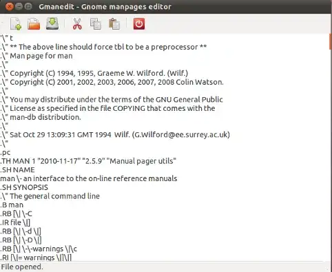

With the help of Gmanedit Install gmanedit you are able to create manpages with a graphical GUI.
Gtk+ Manpages Editor is an editor for man pages that runs on X with GTK+.
Gmanedit is an application which allows you to edit manual pages (man) on Linux/Unix systems.
It is like most common HTML editors but more easy. You need to know manpages format.
According to the Debian FHS user program manpages are stored in usr/share/man/man1 or usr/local/share/man/man1.
After changing manpages it may be wise to update the manpage database by running mandb in a terminal.
Details on the manpage syntax are summarized in the manpage for man.
