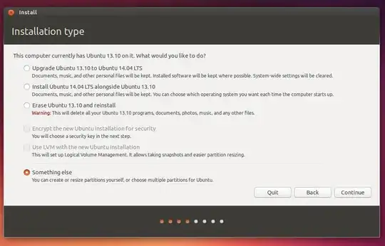

By default, Ubuntu uses the whole disk for installation. In your case you should have done the installation steps untill you can choose "installation type" and choose "something else" there. Then remove the windows partition and create a swap partition of, let's say 1GB and an ext4 partition to install the system on (mountpoint /).

choose "something else" enter image description here

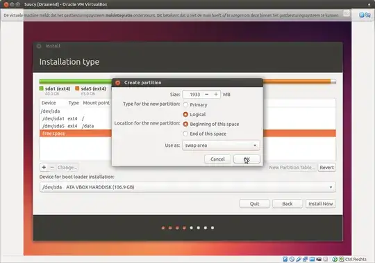

create new partitions (in your case somthing like 1x 20GB for Ubuntu, 2gb for swap, the rest for /data (the picture shows adding the swap partition)
Start with the system partition, mountpoint /, then the data partition, /data, and finish with the swap partition. If you do it like that, Ubuntu will set the "type of the new partition" automatically correct. enter image description here

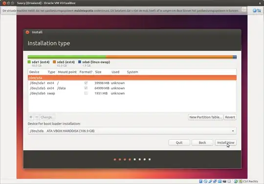

and ready to install: enter image description here`
