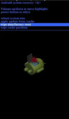

Try booting into System Recovery Mode..
Press and hold the Volume Down button, and press then Power button until the screen lights up. Then select Recovery and press Power button to confirm.
Might look something like this:
From androidcentral.com's forums
