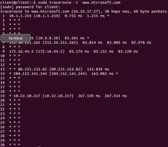

Here i will show you how Microsoft.com block ICMP requests .
ICMP means Internet Control Message Protocol , echo request and echo response are the two operation codes of ICMP used to implement ping .
Bad ICMP packets are used for attacks such as :
Ping of death
ICMP flood attack
ICMP nuke attack
So Microsoft protect there Network by blocking ping_ICMP ana Traceroute_ICMP , so attackers want use it to exploit there system or know information about there network.
The Tracoute using ICMP (-I) option , shows that routers of microsoft block it and you can see asterisks , and blocking these ICMP packets , disable the ability to ping microsoft.com.
