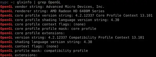

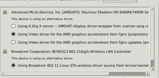

I am on Xubuntu 13.10 64 bit. This question tells you everything you need to know about my graphic card.
Yesterday I had a problem, my graphic card driver failed, now if I login to xubuntu default desktop, all I see is a black screen however I can login to xfce session
The output of inxi -G:
Graphics:  Card-1: Intel 2nd Generation Core Processor Family Integrated Graphics Controller
           Card-2: Advanced Micro Devices [AMD/ATI] Seymour [Radeon HD 6400M/7400M Series]
           X.Org: 1.14.5 drivers: fglrx,intel Resolution: 1366x768@60.0hz
           GLX Renderer: AMD Radeon HD 6400M Series GLX Version: 4.2.12337 - CPC 13.101
