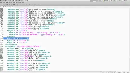

  2. You can edit the file /usr/share/mime/packages/freedesktop.org.xml, search for the extension you want to ignore and delete the line. Below is an example.
Supose I don't want Nautilus to associate ".txt" extension and I want it to look at the "magic number" instead.
I. Edit the file:
sudo gedit /usr/share/mime/packages/freedesktop.org.xml
I will look for a line with <glob pattern="*.txt"/> and delete it:
II. Save.
III. Run:
sudo update-mime-database /usr/share/mime
Done!

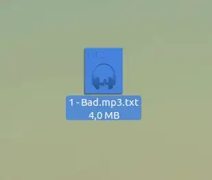

This is how it looks if I change the extension to txt:
This is how it looks if I edit the file above and then change the extension:
