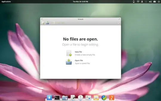

The changes you are proposing are not easy to accomplish. I have a desktop like that using another environment, different from Unity, that is the default you find in ubuntu. This is Elementary OS Luna, based on Ubuntu 12.04. Everything that runs in that ubuntu version also runs here:
http://elementaryos.org/img/home/2-big.png
You should consider try another distro / session for what you are looking for. You can add an elementary session following several tutorials on the web. I made a post a while to add a session of EOS in Ubuntu in spanish though. You can check How can I install elementary OS on Ubuntu? and http://ubuntuportal.com/2012/05/install-elementary-desktop-environment-in-ubuntu-12-04-lts.html for further info.
