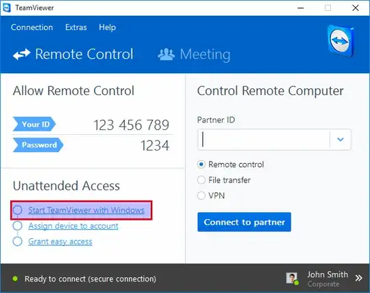

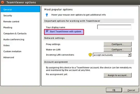

A simple approach that works for me:
  1. Enable Teamviewer at start up
Go to Extras -> Options -> General -> Check Start TeamViewer with system
  1. Enable Teamviewer before login
    sudo nano /etc/gdm3/custom.conf
Uncomment this line:
WaylandEnable=false
I was using Teamviewer version 9 and there is option Start TeamViewer with system. By enabling this option, teamviewer register as a system service and automatically start with the system. Reboot system and it starts with the system before logging in.
In Teamviewer 11, it can be enabled from the main desk.

The simplest way is:
In TeamViewer, go to Extras > Options > General > check the box next to "Start TeamViewer with system"/
You will need to assign the computer to your account otherwise passwords can change anytime.
