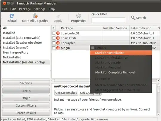

*) If you didn't choose to also delete configuration files, you might be able to easily reinstall the software via Synaptic: select the Not installed (residual config) item in the left pane, then select the software in the right pane for reinstallation:
