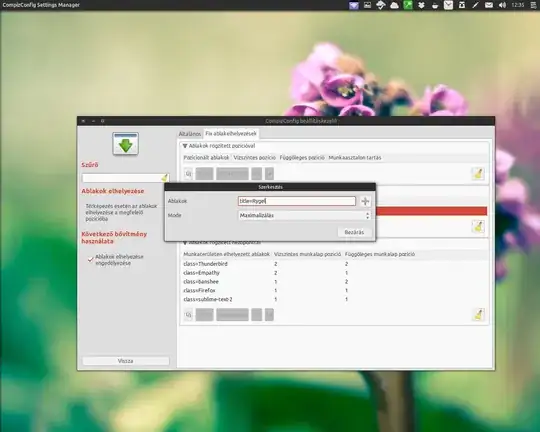

When running Unity, I can use the Fixed Window Placement Compiz plugin with ccsm. I have to add an entry under "Windows with fixed placement mode", and set its condition to "title=Rygel", and mode to Maximized.
CompizConfig settings showing the reqired setting
Screenshot is in Hungarian (my native language), but you get the idea.
Note: The solution tends to work with some situations only, but mostly it's okay. If someone knows why, please tell me in a comment or something.
