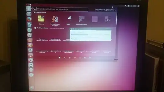

Installed Ubuntu, updates installed.
Clicked in the search lens, then the

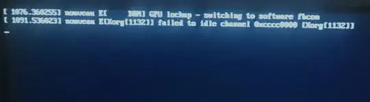

It hung there for about 15 minutes and then got out,

Boot using live disc. Hold down shift to get to boot options. You should get a menu to try Ubuntu before installing, Install to disc etc etc.
Hit F6 and choose nomodset, then press escape.
Choose the boot option you want.
If you get in then you will likely need install the proprietary driver for you card.
