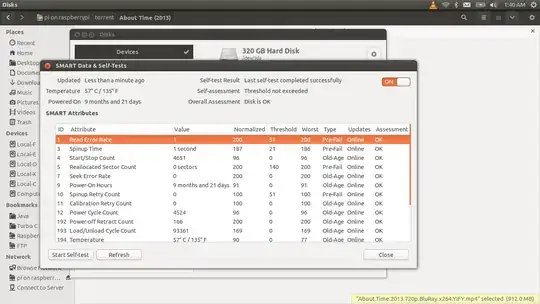

drwxrwxrwx 2 rnztx rnztx 360812544 Feb 22 01:03 NvXhVL3Rue/ result of smart test ! enter image description here
this problem probably cause because of BleachBit(root), because just previously I used that, and NON-REMOVABLE NvXhVL3Rue folder got created.
Running a "SMART data & self test" from DISK utility for that partition helped to delete that folder
