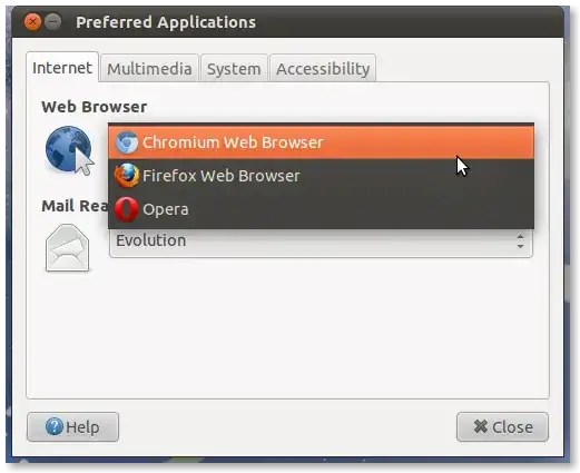

You should choose the default browser: Chromium Web Browser in your case.
Go to System --> Administration --> Preferred Applications
