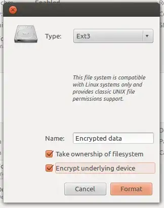

You could also encrypt any existing free space on a USB key or on your hard disk that has been made available by partitioning/resizing it as such, via the disk utility: enter image description here
Using a partition or external USB storage is a bit less convenient but the easiest to setup in my experience.
