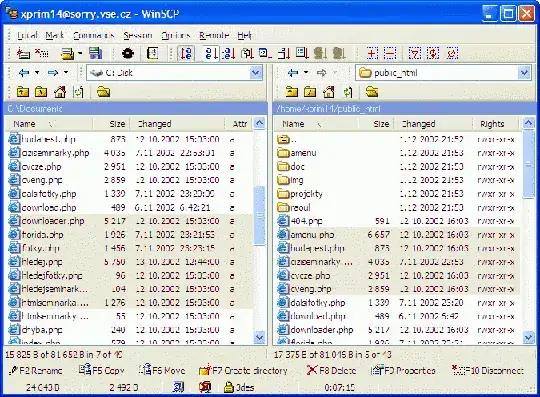

From a Windows client, use Winscp
http://winscp.net/eng/index.php
winscp
