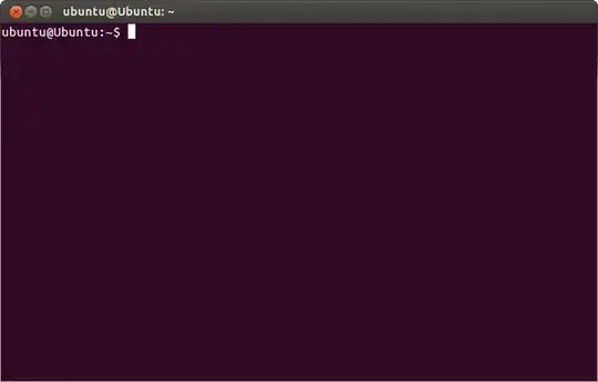

Open the terminal with Ctrl+Alt+T, or search in the dash for 'Terminal' and open it
screenshot of the default terminal
Then enter the following:
sudo apt-get install firefox ubuntu-restricted-extras
You will be asked for your password to give it permission to install the above stuff
apt-get is the command line installer included in Ubuntu. You could also use the Software Centre if it is installed. See the manual for the Software Centre.

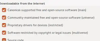

For any of the above, make sure all the repositories are enabled in Software & Updates:
Screenshot of repositories list
