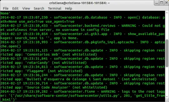

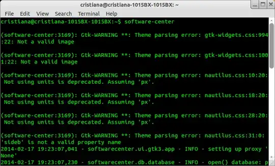

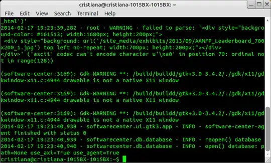

I tried to open Software Center using the command line
software-center
and it did work. I mean, Software Center opened and works fine, BUT, at the same time, in the Terminal window I see a lot of strange errors. How can that be? I'm puzzled.
Is there any explanation for this (and a fix for it)? I repeat, the app does open and it works fine, is only the lines in the background that show that something is not all right.
Here are the screen-shots with all the lines.

The messages you see being printed to the console are not necessarily errors. Most of the ones in your screen shots are in fact, just informative, or warnings. The warnings about theme handling, are due to the GTK+ theme you are using. They are not fatal, but they do need to be fixed by whomever made the theme, and they may in the future cause greater issues if they do not get fixed.
Some of the WARNINGS that are actually from the software-center application, are really just information.
Generally, these warnings and info messages can be safely ignored.
