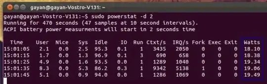

powerstat: Power Consumption Calculator for Ubuntu Linux
For that, open your Terminal and enter the below commands.
sudo apt-add-repository ppa:colin-king/powermanagement
sudo apt-get update
sudo apt-get install powerstat
This should handle your request...
For more information and how to use check this
