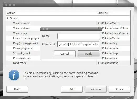

I don't know if there's a way to hold a key down to toggle the touchpad on and off, but you can set a keyboard shortcut to do so. Open up Keyboard Shortcuts, then press the 'Add' button and, under command, enter gconftool-2 /desktop/gnome/peripherals/touchpad/touchpad_enabled --toggle. Enter a name for the action, e.g. 'Toggle touchpad'. After applying, back in the main Keyboard Shortcuts window, under the 'Shortcut' column, enter in a keyboard shortcut of your choice.
screenshot of keyboard shortcuts
