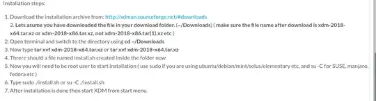

In 2018 version (and later) the apt-get solution doesn't work.
2018 was the version that had to be installed like so:
and contained an archive with just the install.sh script and a readme file.
But in the readme file we have the solution:
sudo /opt/xdman/uninstall.sh
XDM is successfully removed from your computer
