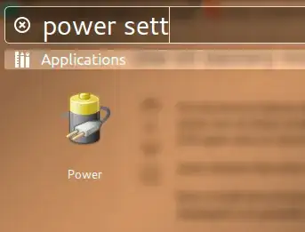

Got to Power settings:
Search for Power settings in Dash

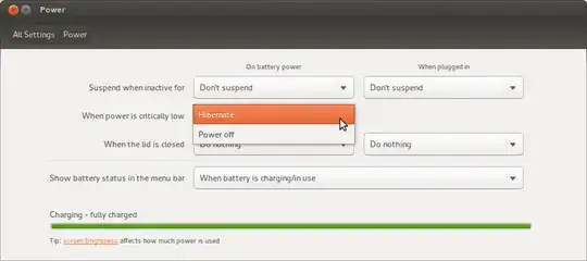

Then you should be able to set how it behave:
Set 'When Power is critically low' to 'Hibernate'
Make sure you enable hibernation first.
