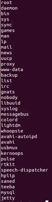

I want to use this command to get the same info but for all users for example :
I used this command .. because it easy for me .. to store its output in a variables in a bash scrip ...
