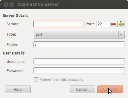

Connect to Host and login via GUI file manager (e.g., Nautilus) for more visual SFTP access to enable file transfers
  1. Open Nautilus on Client
  2. Select File > Connect to Server
  3. Type: SSH
  4. Server: Enter Host's IP address
  5. Port: port number specified in Host's sshd_config file
  6. User name: username
  7. Password: password
In 14.04:
  2. Connect to Server
  3. Type: `ssh @123.123.1.23:
