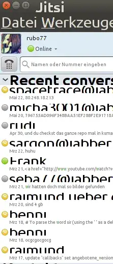

I installed Jitsi Chat on my Lenovo Yoga 2 Pro on Kubuntu.
I already adjusted the main Fonts to 230Dpi in KDE settings, but Jitsi doesent obey this.
How can I enlarge fonts in Jitsi too?
Unity
On Ubuntu 14.04 it is also a problem: There I adjusted the overall text-scale-factor to x2.0 with unity-tweak-tool, and it adjusts the fonts in jitsy as desired, but it doesnt ajust the lineheight of one contact:

Starting with 14.04 we have an option that helps a bit:
Scaling Support
In the image below we can see the scaling it has at 0.75 on the fonts and title bars:
Set this to factor 2.0 and revert your text-scale-factor to x1.0 in unity-tweak-tool,
This enhances the Juitsi interface a bit, (but not in all places)
