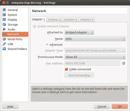

Virtualbox configuration for Vms:

This will not work in a Bridged Networking setup. From the VirtualBox documentation:
Bridged networking
This is for more advanced networking needs such as network simulations and running servers in a guest. When enabled, VirtualBox connects to one of your installed network cards and exchanges network packets directly, circumventing your host operating system's network stack.
Since your virtual machines are using eth0 directly, they are unaware of the tun0 interface to the tunnel running over it. You will need to use a different virtual networking configuration.
