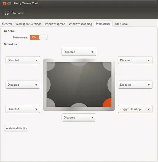

Anyway, using unity-tweak-tool, set this...
enter image description here ..and you should be able to show & hide the desktop by placing the mouse in the lower-right corner - it works very nicely in 13.10.
