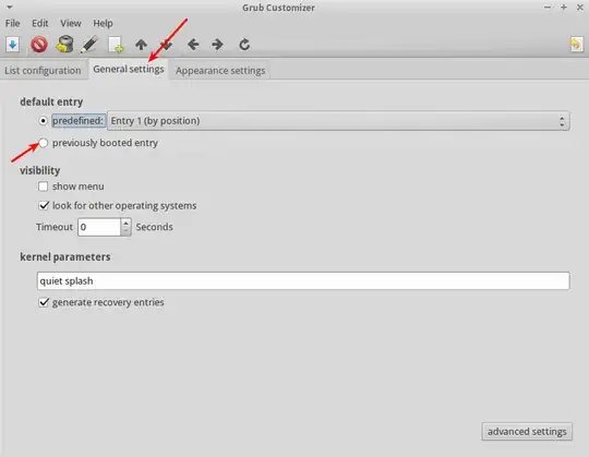

Try Grub Customizer. To install, just press Ctrl+Alt+T on your keyboard to open Terminal. When it opens, run the command(s) below:
sudo add-apt-repository ppa:adabbas/1stppa
sudo apt-get update
sudo apt-get install grub-customizer
Once installed, just type grub-customizer in terminal, to run the program, when it open try to change the default entry under the General settings tab. See image below.
