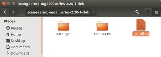

The content of the scangear package looks like this:
scangear5500
Run the highlighted install.sh script to install the scanner requirements.
The content of the IJ package looks very similar, and again, run the install.sh script to install the printer requirements.
