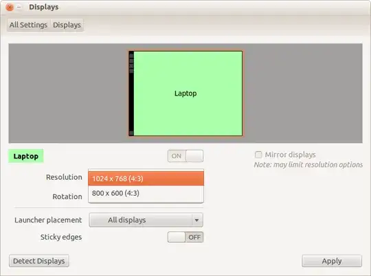

In "Displays" in the settings, the were only two resolution options: 1024x768 and 800x600.

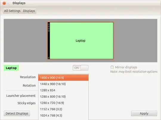

When I rebooted the resolution was back to normal and the other resolutions reappeared under "Displays".
