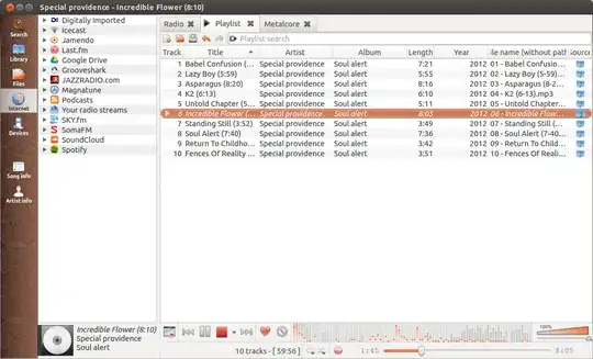

I have a strange problem with QT theme in Clementine. When it is run from sound menu (notification area), it has Windows classic theme:
Clementine with Windows classic theme

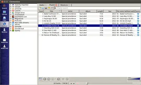

When it is run from terminal or Ubuntu menu, it looks OK:
Clementine how it should look
In both cases the 'clementine' process is run without any arguments.
How can I fix it?

I have the same issue on Ubuntu 14.04, workaround it with qtconfig! run qtconfig and select GUI style GTK+
This GTK+ theme looks same as Ubuntu theme just some icons are different...
