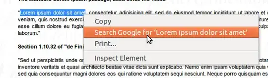

I want to have an option like Search on Google available in selected text's context menu in gnome-terminal. Something similar to the option which is available in selected text's context menu in google chrome / chromium / firefox browser:
search google
So, something similar like in the above image, but in gnome-terminal. Is this possible?

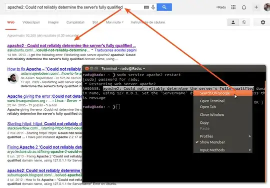

From now, when you will open your gnome-terminal you can quickly search on Google command line errors, warnings and other things. Highlight the text, right-click on it and choose "Search on Google". It opens the default web browser and go to the google search result page:

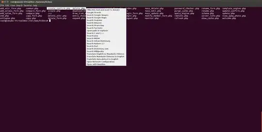

Using Colinker, a customizable context menu for selected text, you can search selected text in any application not just the gnome terminal. On Linux systems, Colinker is designed to be used with xbindkeys and xclip.

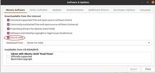

Ubuntu 18.04
  1. Enable source code in "Software and Updates" Enable source code in "Software and Updates"
