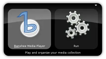

You probably are seraching for gnome-do application. It's easy simple and cute app for esearching for items, files and other apps in your system, and many other utilities.
Simply install it by sudo apt-get install gnome-do enter image description here

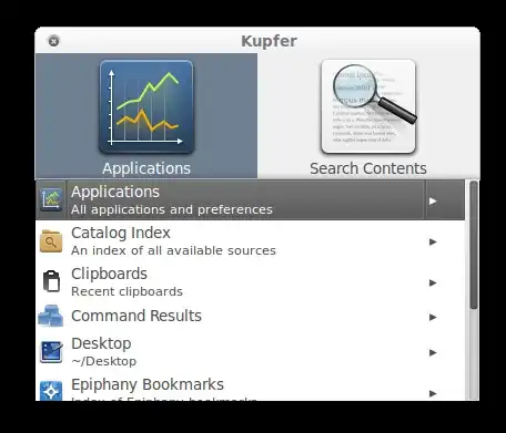

You can also give a try for kupfer and synapse
To install Kupfer
sudo add-apt-repository ppa:kupfer-team/ppa && sudo apt-get update
sudo apt-get install kupfer

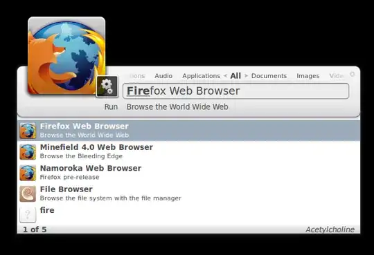

To install Synapse
sudo add-apt-repository ppa:synapse-core/ppa && sudo apt-get update
sudo apt-get install synapse

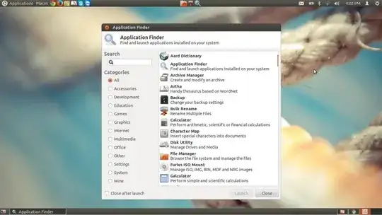

In between I also got one application finder : xfce4-appfinder which comes with XFCE desktop environment. But it is standalone application finder and doesn't require any additional package of XFCE.
To install it simply execute this command:
sudo apt-get install xfce4-appfinder
One single package will be installed silently and would work for all desktop environments.
Here is my image:
