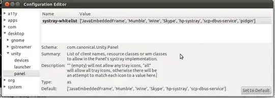

You have to whitelist the applications if you want to allow them to access the system tray.
Firstly install dconf-tools from the software center ( or by clicking here) Then Press Alt+F2 and enter dconf-editor and run it.
dconf-editor alt-f2 dialog
Now navigate to Desktop -> Unity -> Panel.
configuration editor (dconf-editor) desktop.unity.panel
Now change the value of systray-whitelist to
['JavaEmbeddedFrame', 'Mumble', 'Wine', 'Skype', 'hp-systray', 'scp-dbus-service', 'Pidgin']

Now for any other application to show up in the systray run the following code in the terminal: gsettings set com.canonical.Unity.Panel systray-whitelist "['all']"
