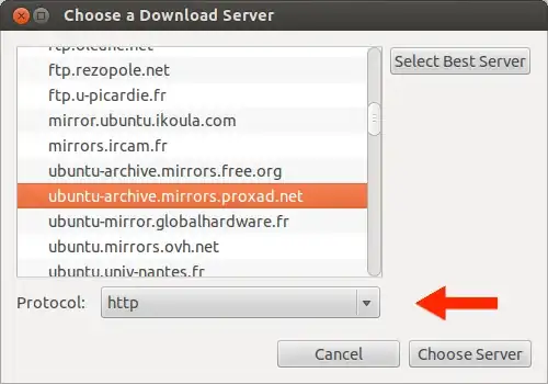

In Update Manager's software sources, the option exists to choose a download server and protocol like shown below.
Do all updates download via HTTP only?
And if HTTPS (or SFTP) aren't supported, why does the option exist? Related question here, though it only deals with full ISO images.
Choose a download server screenshot

Potentially yes the software showing the drop-down of protocols can support a https mirror - the drop-down box in question accepts the following valid protocols:
  • ftp
  • http
  • file
  • rsync
  • https
This is detailed in the software-properties-gtk package source code:
apt-get source software-properties-gtk
cd software-properties*/softwareproperties/gtk
Look in the file DialogMirror.py - function def is_valid_mirror
there is a but...
However in reality, the public mirrors Ubuntu supports is limited to http://, ftp:// & rsync://
The mirrors you can define is limited when you define a new mirror:
local mirrors
Therefore, since the software itself does not limit the protocols, one way to download over HTTPS is to define and maintain your own local repository & mirror. As usual we have a great Q&A that have several applicable answers:
