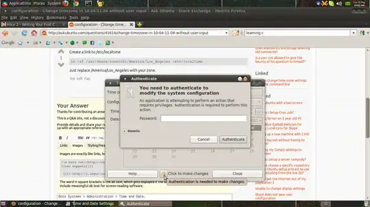

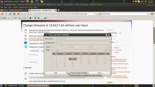

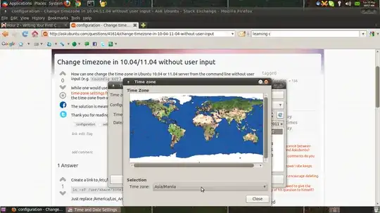

Goto Systems > Administration > Time and Date.
Then press the padlock icon beside "Click to make changes", enter your password to authenticate, now you can change your Time Zone.
